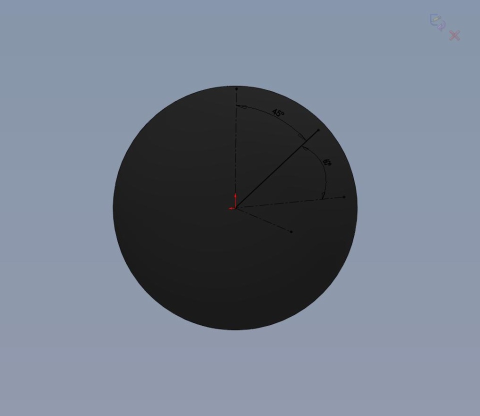

This may be slightly obscure, but I am trying to figure outif there is a way to place a sketch relative to a view (i.e. rotatea part till it's right, then place a sketch parallel to yourcomputer screen - say through the part origin).
Is there a way to do this?
I've thought about
* is there a way to determine the direction you're looking from(say x,y,z angles) so that you could manually rotate a plane aboutthe origin?
Or,

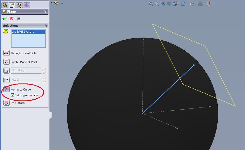

* is there a way to get a direction vector that you could thenreconstruct as a 3d sketch (line from x,y,z to 0,0,0) so that youcould then place a plane at the end of the 3d sketch line normal tothe line?
Any ideas whatsoever I'd appreciate it.
Thank You,
Mike
PS: As to why (maybe there's another way to do this) ... I'm tryingto place an picture underneath a part (i.e Sketch Picture) and thenmodel the part over the picture using the picture as a reference.Problem is that the picture isn't straight view or isometric, soyou can't use standard views but need to rotate a "starting block"into position to set up your default planes. I could place thepicture into the screen background, but that won't scale like aSketch Picture would, plus it would just stay there and neverrotate or pan, which will get annoying fast.

Steve
this may potentially work. I was concerned because all the lines onthe sketch picture are shown foreshortened.
But as long as you can set (i.e somehow define) the extrusiondirection(s) to not be perpendicular to the sketch plane
(but perpendicular to each other), that could work.
I had planned on using Instant3D to quickly "sketch" the model, butI think that only goes perpendicular
to the sketch plane, so this would no longer be an option. Maybe ifI establish the base extrusion only
from this default sketch plane, I could then proceed via Instant 3Don the resulting side faces.
In both of your suggestions, defining that direction is the trickypart
(and knowing the "view vector" would help).
I'll give it a try.
Thanks for the pointers,
Mike
That said, I think i would use some sketch geometry to define aplane approximately you want the view from, then click view normalto the plane, adjust the plane, normal again, adjust the planeagain, normal again...repeat as long as necessary. Not quite aseasy as you are asking for, but effectively doing what you areasking.
-Devon
