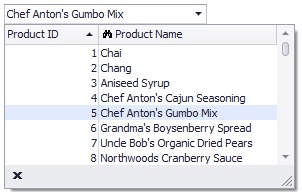

I am creating .NET usercontrols to be used within SolidWorks Property Manager Pages. One of these usercontrols contains a Developer Express LookupEdit control. This control has a textbox with an embedded  dropdown window. Users can type text into the textbox part of the control and items in the dropdown list are automatically selected. This can be seen in the picture below.
There is a problem however when we type characters into the text editor part of the control. None of the keypresses are seen by the control. Other controls such as a Microsoft ComboBox or a Developer Express ComboBoxEdit do see the characters being typed. I have already tried several ways to solve this and I am fairly sure the problem does not lie with the LookupEdit control itself.
