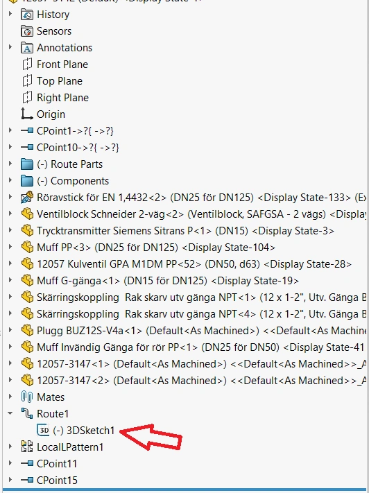

Piping: Sketch ends up external to route when saving in 2026.
Hi,
We just updated from 2022 to 2026. Creating new routs works just fine, and the old library works. We do not us a PDM, al cad files are located on a network server in a folder structure.
But: when I open an old routing assembly it looks ok, I can modify it and save it. But when I open it the next time the 3d sketch that defines the route is external to the route feature. When this happens the route is no longer editable in the way it should be.
Anyone seen this before and know what causes it and how to mitigate or repair broken ones.
If I take the broken route part and make a Pack&Go to a local folder on C: it repairs itself as long as all parts are in a local folder. If I re link some routing componets to the server it breaks down again.
