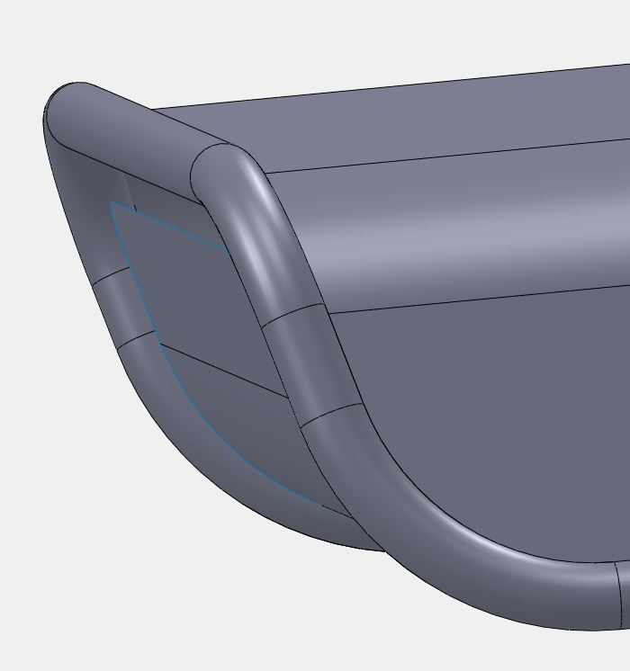

in solidworks i have to use the sweep command - so i have to create another sketch (circle) and extrude it along the 3d sketch.
with this swept surface i can trim away. bottom surfaces trimmed by big sweep.
i can use different radii for the trims. small radius for the top trim.
and from there i can loft these edges with compound curves.

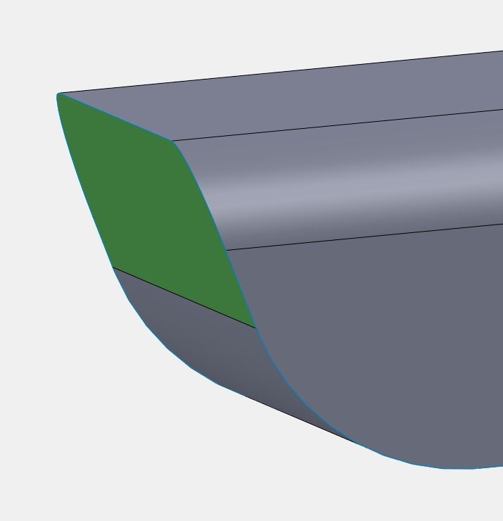

the problem is - the swept surface is not a very clean surface. now of course i can't have a equal or bigger radius for the profile, than the minimal radius of the path curve.
but even when i chose a smaller one, the swept surface is wrinkly (due to surface tensions) and results in a nasty trim. i checked all options of the swept surface like minimum twist etc..it often results in a bad surface when the radius is a bit big.

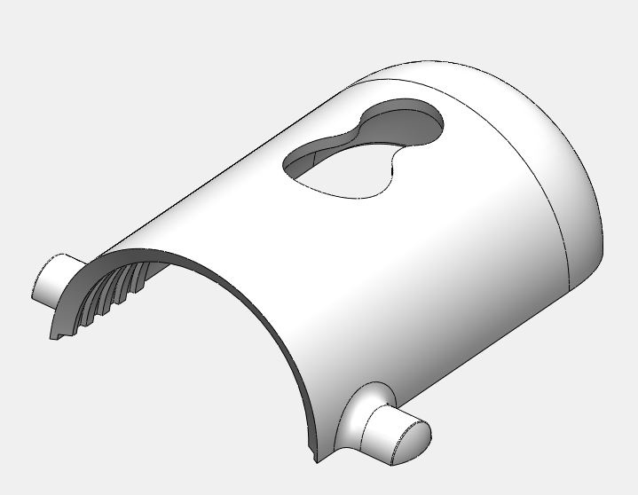

so here is a cumbersome way (on another part)

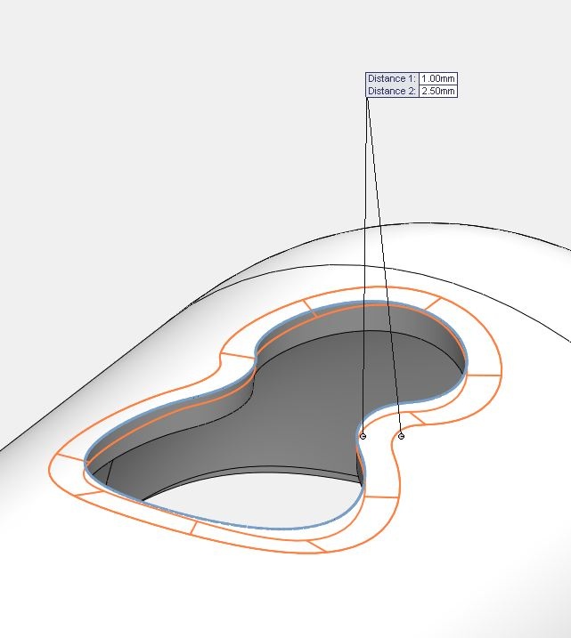

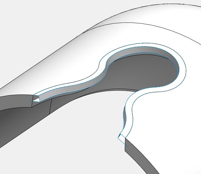

again, i want a very shallow chamfer, going 1mm down and 3mm outside

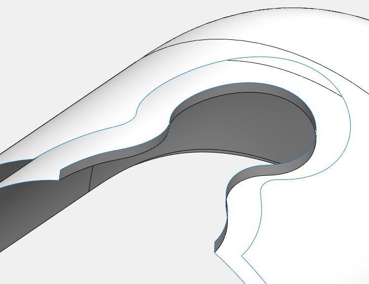

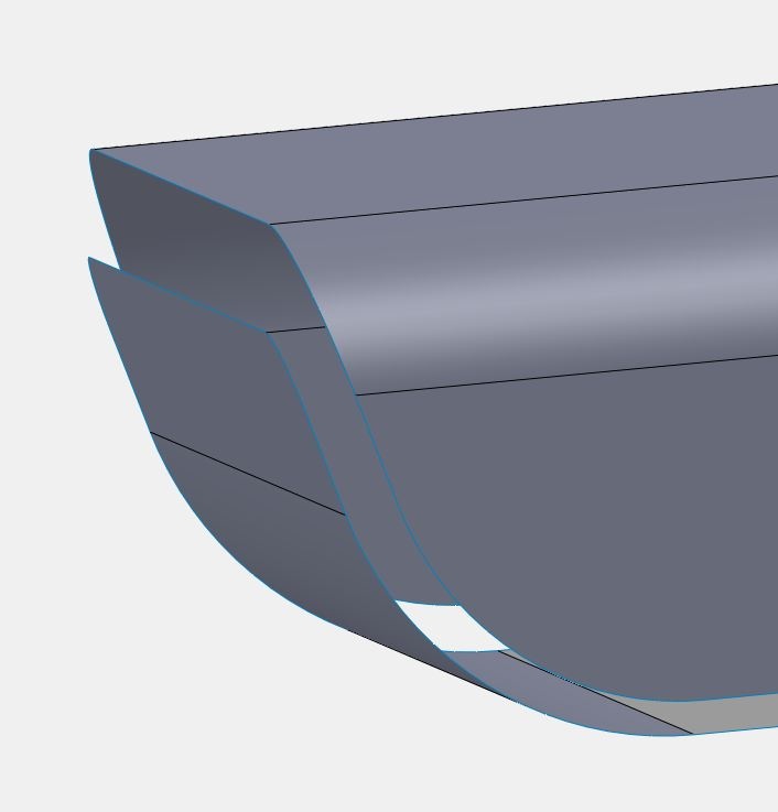

so from the top edge i use a ruled surface going inside the hole tangent to the surface. then another ruled surface going down, perpendicular to the first ruled surface. then again perpendicular to the second another ruled surface - big enough to penetrate the extruded hole. this way i now have a clean ruled surface with wich i can trim.
trimmed away surface with ruled surface

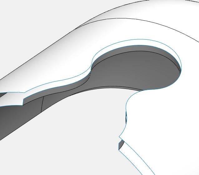

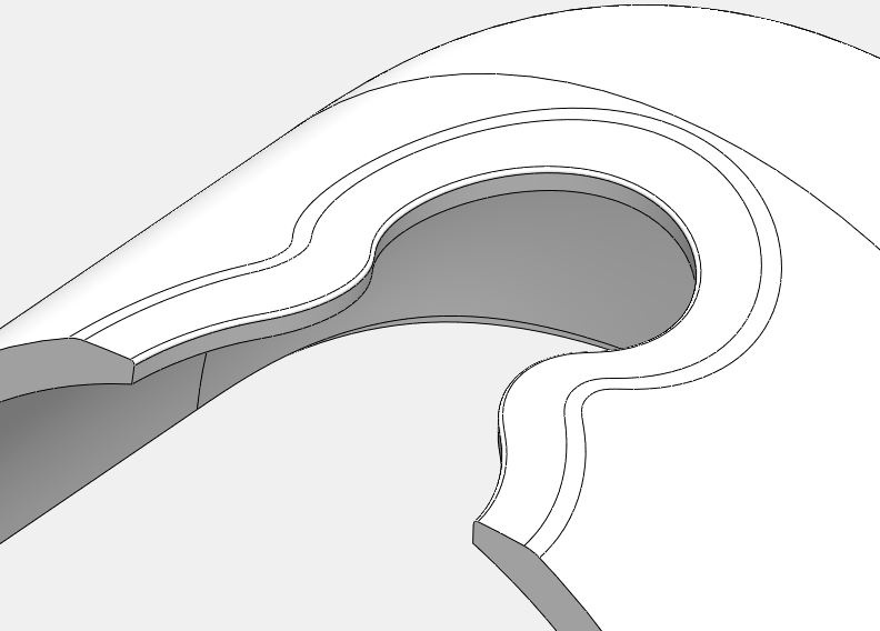

for the top surface, an offset curve from the original curve that create the hole is fine. i trim with that offset curve.
now i can loft or patch the surface and filet it.
i know there are many other ways to do this, i just wish we had a pipe command.
EDIT:

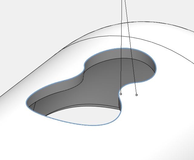

here you can see the chamfer feature fails, because in one direction the distance is too big (3mm)
with 2.5mm it works - looking at the resulting outer boundary of the chamfer the minimal radius at the 'waist' of the 8-shaped cut is big enough, it should even allow a 4mm chamfer in that direction - but it does not..hence the work around

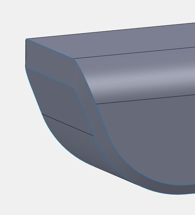

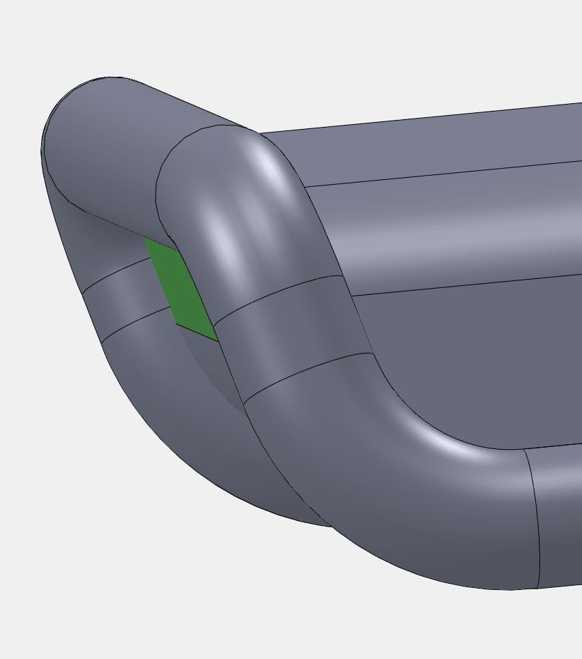

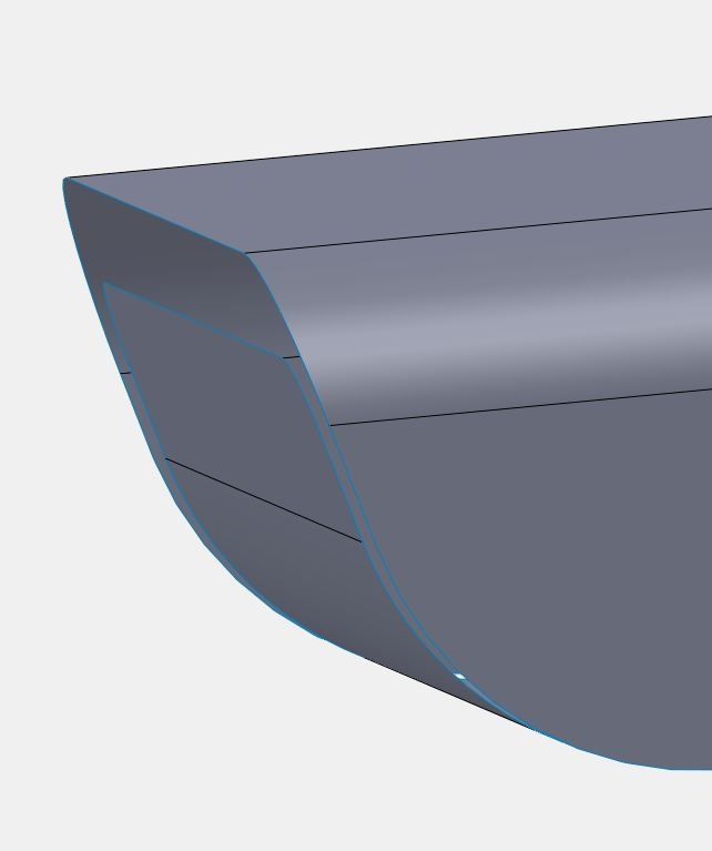

here is an exagerated example on how nasty a swept surface can be when the radius of the profile curve is almost as big as the min radius of the path curve. even with smaller radii the swept curve is nevery truly clean for a neat trim.
resulting trim does not flow nicely..has a kink

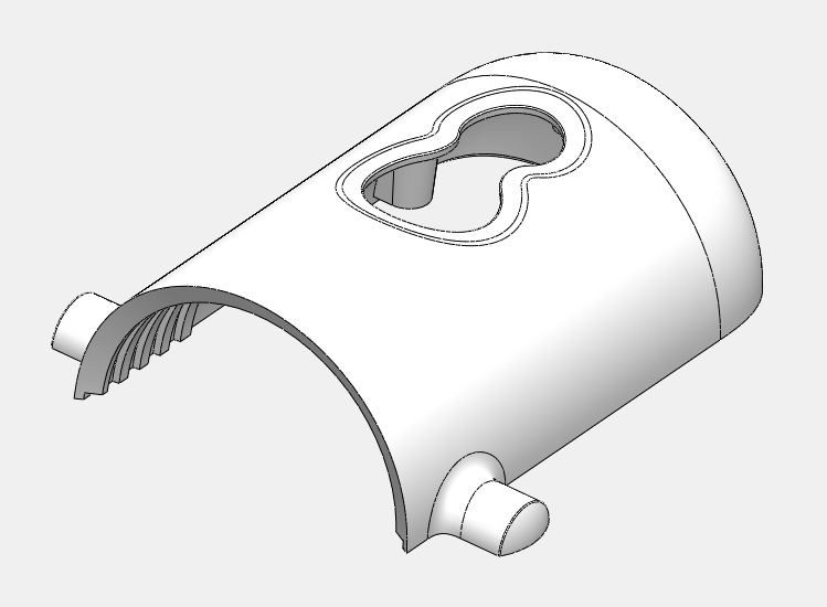

here is what the product looks like
