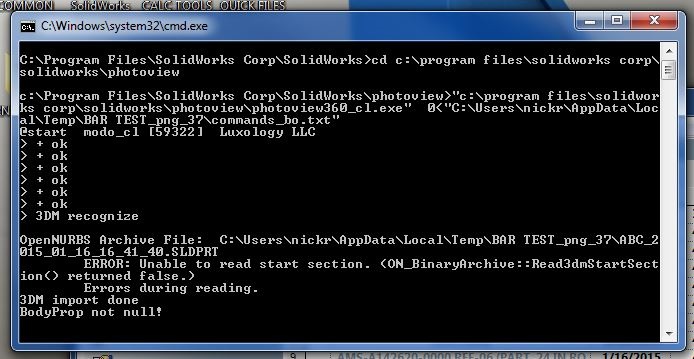

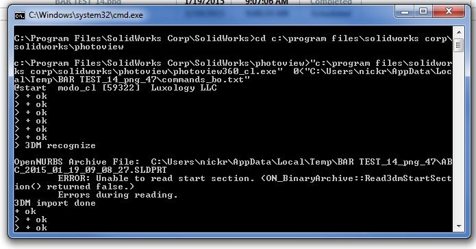

     I am using appearances from the Modo/luxology community (called Modo assets) in Solidworks 2013 and have successfully rendered the image in the traditional way. Yet, when I try and perform a scheduled render, these appearances bug out and will randomly render out in different colors...sometimes even with the correct appearance!...but that only happens once in a blue moon. I'm trying to decipher the madness...with no luck so far.
The error I see:
OR
Things I have tried:
