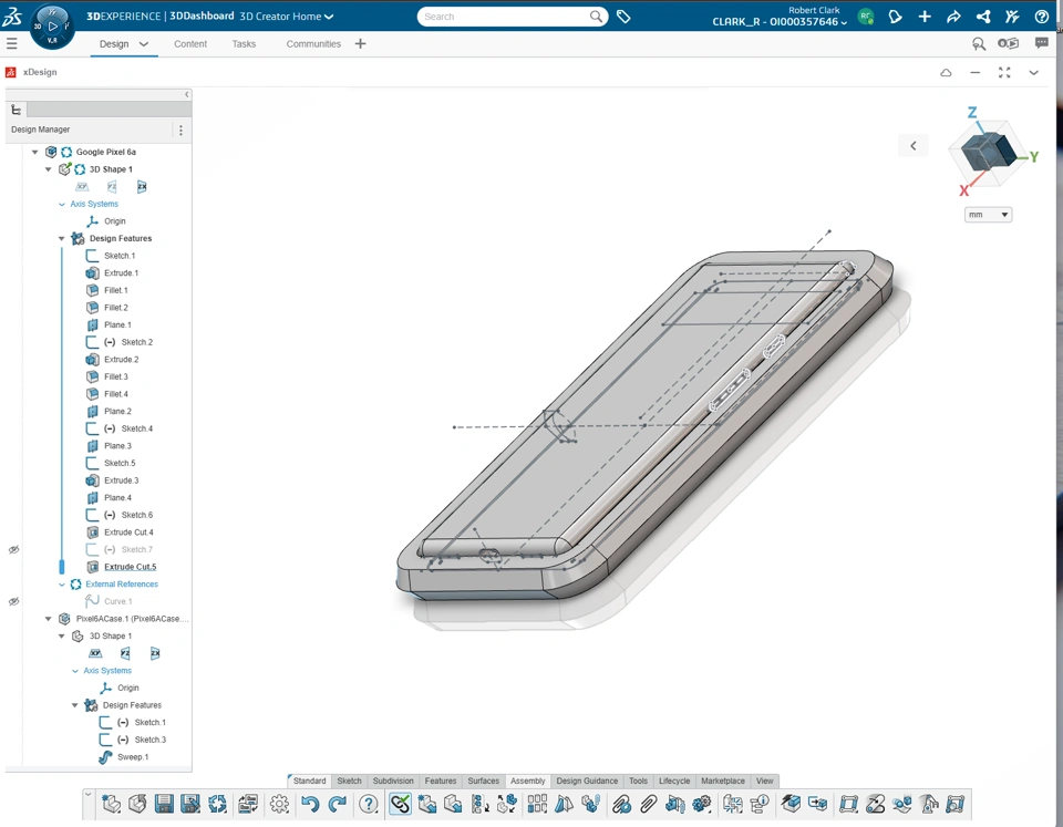

I'm just learning SolidWorks and thought designing a cell phone case would be a great first project.
So I've modeled my cell phone and all its buttons in xDesign as a part. I've 3D printed it and validated it against the real phone as a reference to build the case around.
I mocked up just a simple case for a starter part in xDesign. Now I would like to bring my phone guide shape and my case shape together in an assembly so I can see where the phone features are while I work on the case shape.
I've inserted the case into the phone workspace and they've come out mis-aligned. Again these parts will be fit together but they're really never the same assembly: there isn't any logical joints or rollers or any kind of machine join between the two.
I cannot for the life of me figure out how to get the x, y, and z origins of these two models to align. How do I move one or the other in the Z and X directions so they align? Somehow the x-z planes came out right but I can't tell you why. The phone is hovering well above the case part and mating the origins of the two models won't go. I should be able to just grab one or the other and move it along an axis freehand. But neither will budge. I've tried anchoring and de-anchoring, locking and unlocking. I'm quite literally stuck.
The phone's not really symmetrical in Z so if I had to create a midpoint plane through it that would not be ideal.
And I don't want to align the front face of the phone to the top face of the case model because the case needs to be proud to the phone screen. Nor do I want to align bottom planes because again: case needs to be proud in all directions. And there's not really a flat surface all the way around the x-y directions between the two parts. And I'm not expecting the mid x-y planes of either part to align either.
I need to establish a common x-y plane and a common z-y plane and move both parts to different yet fixed offsets from them. Ideally the origins should coincide but I can't seem to budge the origins. Somehow the parts are aligned on the x-z plane perfectly but I can't tell you why.
Please advise. I'd be relieved if I could just somehow manage to move one or the other part AT ALL in this assembly.
