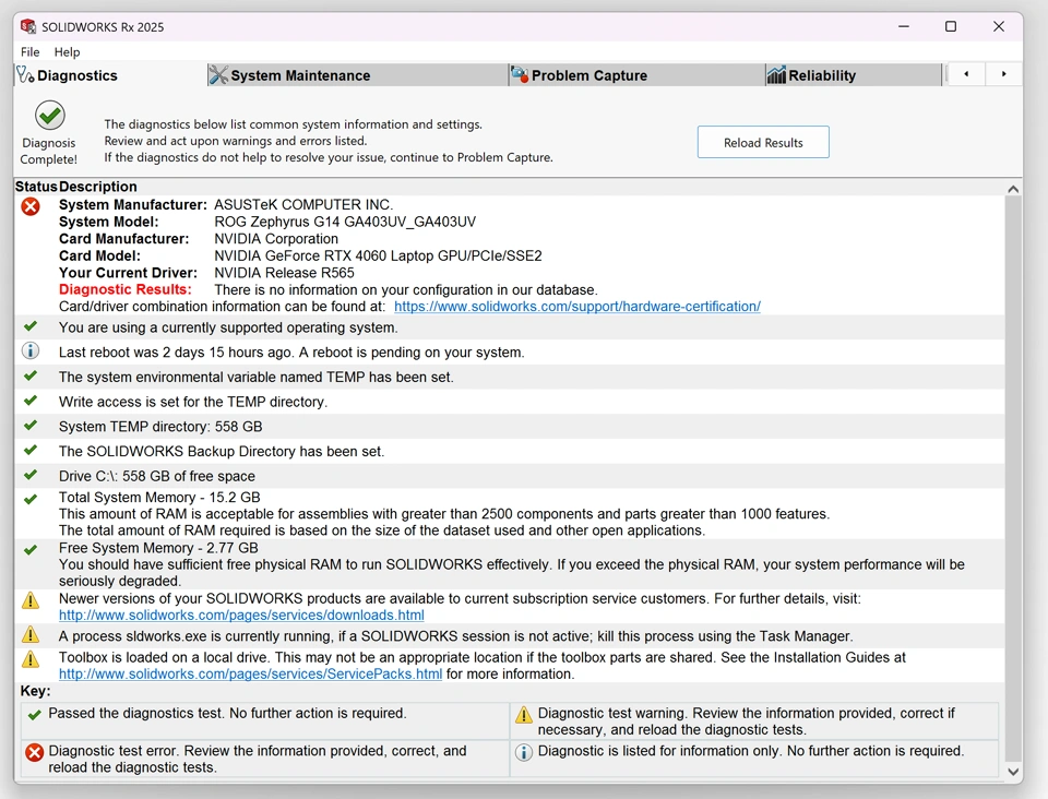

I'm experiencing several persistent issues with my SOLIDWORKS installation that significantly affect usability:
  • I receive repeated “low memory” warnings even when no other applications are open and I’m working with very simple parts.

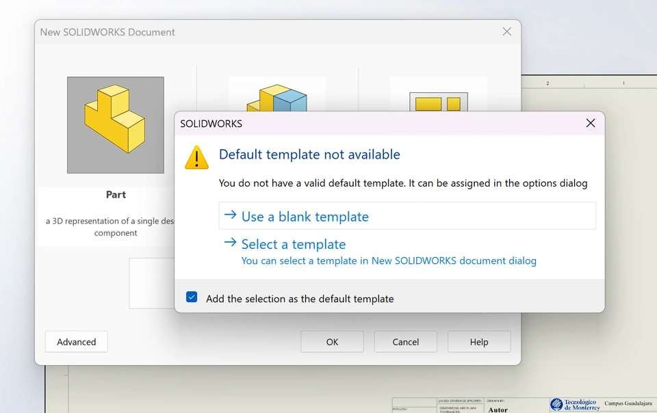

  • The default templates for parts, assemblies, and drawings are missing or not loading properly.

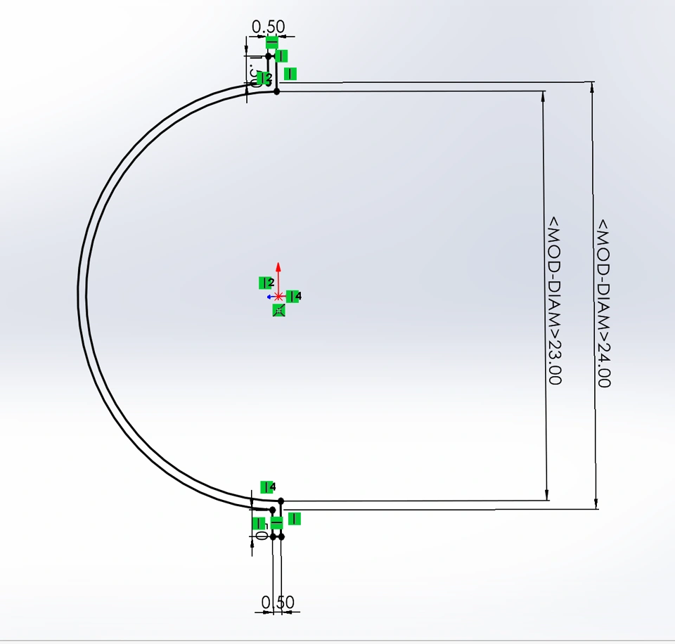

  • In Smart Dimension, symbols like diameter and radius don't display correctly — I get text placeholders like “mod diam” instead.
I have already uninstalled and reinstalled SOLIDWORKS, manually removing all associated files, but the issues persist.
