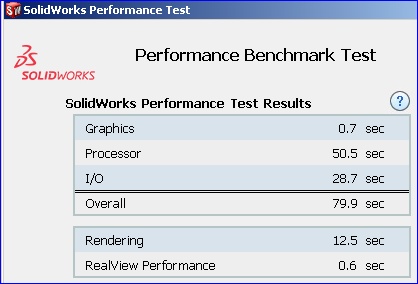

I am testing SW 2014 SP3 with the "SolidWorks Performance test 2014".
My first run was with 2 monitors with 1920 X 1200 native resolution.
Result from CADAdmin Dashboard:
2nd run with 2 monitors (with 1920 X 1080) and mosaic set up to resolution 3840x1200.
Results from 2nd run
When running in mosaic mode the graphics is only 0.7s.
Dual  monitor without mosaic the graphics run is 6,3s
Is this a bug in the testing program or does it indeed run faster with mosaic ?
