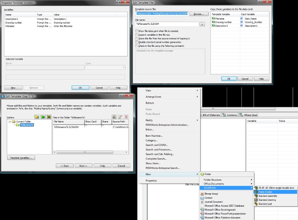

I'm trying to create a SolidWorks assembly using topdown modeling and a design table and then use it as a template in PDMWorks Enterprise 2008 SP3.0
Both the top down and design table in the assembly works perfectly
But when I setup PDMWorks to use this assembly as a tempate, every new assembly created has relations to the original one
Is there anyway to make the internal parts relate to the new filename?
Here is how the template is setup:
Is it possible to use a top down assembly with internal parts as a template which is givin a new name each time my users uses the template "function" in PDMWorks Enterprise?
