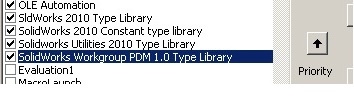

I've looked through several topics on this subject and couldn't find any resolution. I'm trying to access the PDM vault
via VBA and failing at the very first line when trying to declare the connection:
User defined type not defined.
I read somehwere else that I needed to add a reference to a DLL that I could not find:
SolidWorks Workgroup PDM 1.0 Type Library
Here's the code I tried last, it is almost identical to the other one's I've tried.

I have a PDM account. I have SW Office Premium 2008 SP5.0 on XP. I've tried both
before and after I've logged into the vault, though it would seem it should log in itself.
Am I just missing the DLL for the SolidWorks Workgroup PDM 1.0 Type Library or have I not included enough info?
