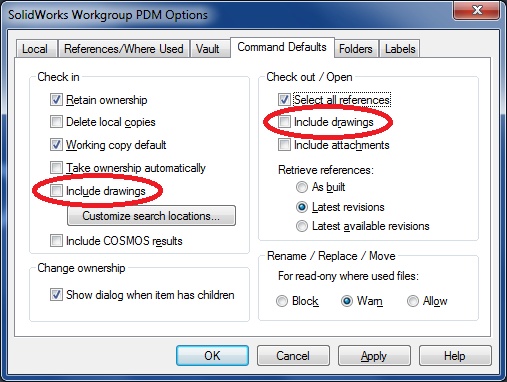

We are running into performance issues with SolidWorks & PDM Workgroup at Check-in & Check-out. What it boils down to is that if we enable the option to "Include drawings" for Check in or Check out under "Command Defaults", PDM Workgroup references a HUGE number of files. Here are the options I'm referring to:
In one example, when checking out a small assembly (several parts, two sub-assemblies, 38 parts total), Workgroup PDM brought up a list of over 3000 parts!!!
Now, it appears that what Workgoup is trying to do is locate & include all parts, assemblies, and drawings that reference any of the components of the assembly in question. I suppose this might be helpful if you are trying to determine how changes made to a particular component will affect anything that references it, but that's not what I'm looking to do here. And besides, there are other ways of accomplishing that.
I just want to include the drawings related to the assembly, and to its constituent components.
Any thoughts on how to achieve this without getting everything, including the kitchen sink??
