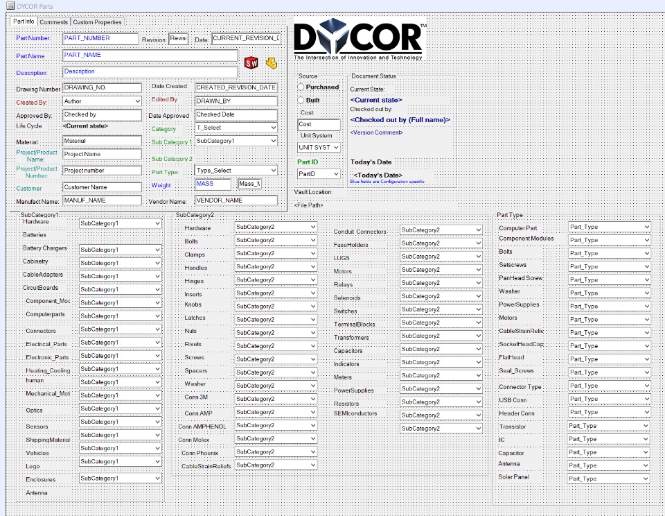

Ok I have set up a set of data cards in PDM Standard, can't afford the expensive PDM Professional and that is over kill for a small company anyway. I have a large Library of parts that i commonly use in many designs. my current data card is still in development but the control logic is so difficult and limiting to configure for ease of use in the interface. here is the part library template, this supports both the Library part and regular project parts.  the bottom section is temporary and will be sorta stacked on top of each when finished in the upper card area once  the data control logic is solid. I haveing problems with the Category and sub categories not sequencing or updating or responding when trying to set them. not sure why. Has anyone else attempted this or tried this?

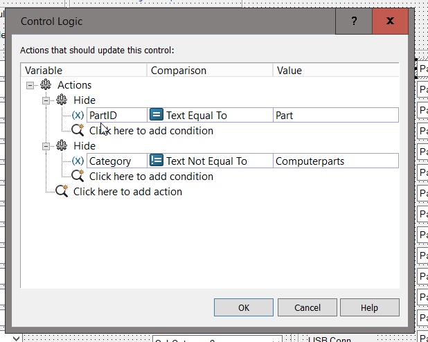

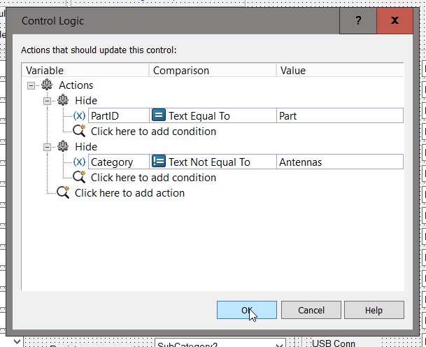

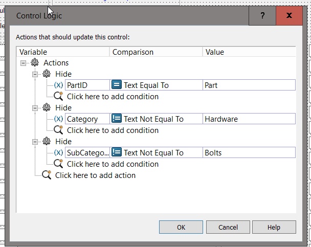

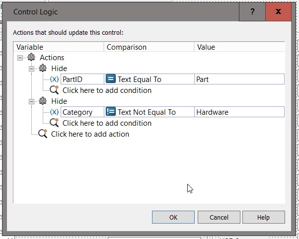

Here are the control logic examples of the fields they are different for each sub cat drop down
Main Category Logic
Sub category 1 logic
Sub category 2 logic
Part type Category Logic
