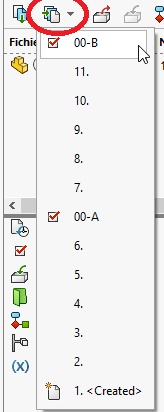

On PDM Pro, I am working on a vba macro to get a specific version of a file.
It will work like this :
- Check out the file (lock)
- Get a specific version
- Check in the file (unlock)
I managed to Check in and out the file whit no trouble, but I can't find the method to get a specific version.
Just like this icon in the PDM menu in Solidworks.
If you guys have an idea.
