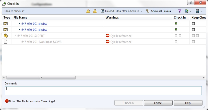

So I had a part with some simulations completed in our Workgroup PDM vault. I updated as assembly that contains that part outside of PDM during our transition from Workgroup PDM to PDM. Then when I went to check in the assembly - BOOM - cyclic reference with absolutely zero guidance on how to resolve it anywhere in the known universe.

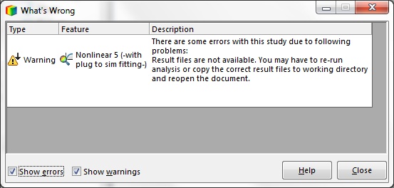

I also saw that half of my studies on the unchanged part were all messed up. For some things were normal - results tree normal, I could show the results. For some the results tree looked normal, but when I tried to show the results I got the error "Database not found". For some, the results tree was grayed out, but I could show the results.

So at this point it appears that PDM says there is a "Cyclic" reference if there is a problem locating the results file.

OK, odd and buggy, but that's what I have come to expect with SW post 2014 version. I see the CWR file in the vault with a modified date from the time the simulation finished, so everything is groovy. All I need to do to get on with my life is check the part back in. And then there you go! I can't check it in because there is a cyclic reference in the part and the CWR file again!!!!!!!! The part has no external references either.

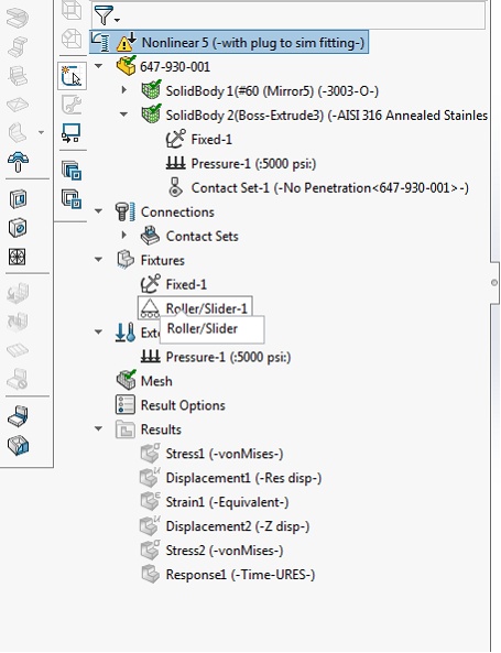

I went to the simulation study tree, RMB on the top level of the study->Options and set the Results Folder to a folder outside the vault to see if that would help. It asked me if I wanted to copy the results. I said yes, and it copied the CWR file to the new folder. Now when I go back to look at the Results Folder location, it is back to the folder in the vault that contains the part.
If I go to the vault folder and unselect the option to check in simulation results and then try to check in the part I see no cyclic references:

OK, so I figure I've wasted too much time troubleshooting this software for SW, so I set the vault back to include the simulation results and save the part file. I get the error of unknown origin that says that it can't create a file in a directory that I have full access to. As there is nothing I can do at this point to make this error go away, I close the file. Now I open the file again to check that the simulation results are available and voila! - no results available. Changing the location of the Results file under the study properties makes no difference- but a least it seems to stay set to the same location after clicking OK.
