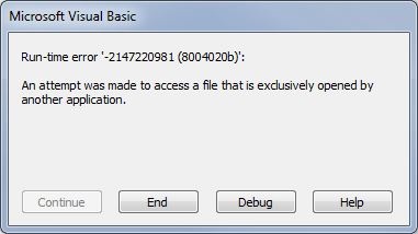

I have started learning PDM APIs and created a macro to get the latest version of the active document in SolidWorks, but I am not able to get the latest vesion. Here are the codes:

You can see the codes are quite similar but for some reason, I am not able to get the latest version of the document. I can get the local version (IEdmFile12::GetLocalVersionNo2) and the current version (IEdmFile5::CurrentVersion) of the document correctly but not able to get the latest version.

But I am still not able to get the latest version of the active document in SolidWorks. What am I missing? I know there are plenty of PDM API gurus here, would someone be able to guide me?
