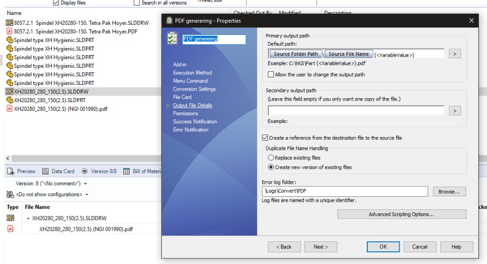

Hi forum,
I made a macro, that during the process moves a zip-file to the vault, adds data to some variables, and finally checks the zip file into the vault. The zip files contains an assembly saved as shelled part. What I would like to do is create a reference between the zip file and the assembly like the way the PDM convert does with drawings and PDFs (see image)
Can any one tell what API I need to use to accomplish this?
