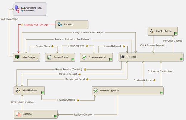

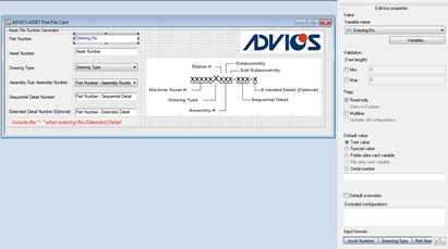

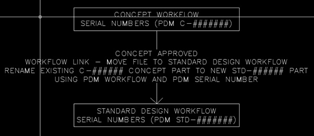

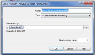

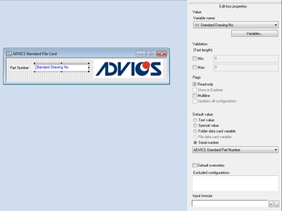

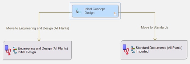

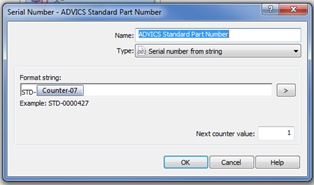

Currently our engineers and designers will come up with concept designs in a user workspace that is uncontrolled. I noticed all the files they are creating use junk names like “Plate, Bearing, etc”. Well below I try and detail my idea of having a serial number generated as the part/file name while in the concept stage (C-#######). This is easy enough and I have this working. I have also done the same for our standard part files (STD-#######). We also have project files that consist of an ASSET number defined in the Project folder along with some use input defined on a part generator card I created (shown below).

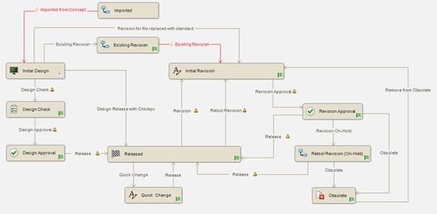

Now comes the difficult part for me since I am trying to learn how to do this. I believe I will need to use API and the PDM Dispatch but not 100% sure. I want to add two transitions from the concept workflow to the Standard Workflow and the Project Workflow as shown below. I would like for the file being transitioned to rename the files per the serial number or a pop-up with my Asset Project number generator if possible.
If there is a better way to handle this please let me know. This process should be able to handle SLDPRT, SLDASM and SLDDRW files. I have seen I can do a saveas and generate a serial but this seems to fall short when doing the drawing file. I would like to use the workflow and automate this as much as I can.

Concept Workflow
Standard workflow
Project Asset Workflow
Concept Parts use the PDM serial number
Standard part numbers use a PDM serial number
When creating a project part we use this card to generate the part number with some info from the folder card and some from manual input from the operator.
