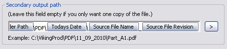

I've got a task set up to spit out a pdf that we dump out into a network drive to use on the shop floor. I'm having a problem with the task adding the revision to the file name. I have it set up to add a _Revision (i.e. xyz_B.2.pdf) into a folder our print clerk uses to dump the latest pdfs of drawings into a network drive for the shop floor. For some reason it won't add the revision to the file name so I get xyz_.pdf. from what I can tell it's set up correctly. Any idea what's possibly going on here?
