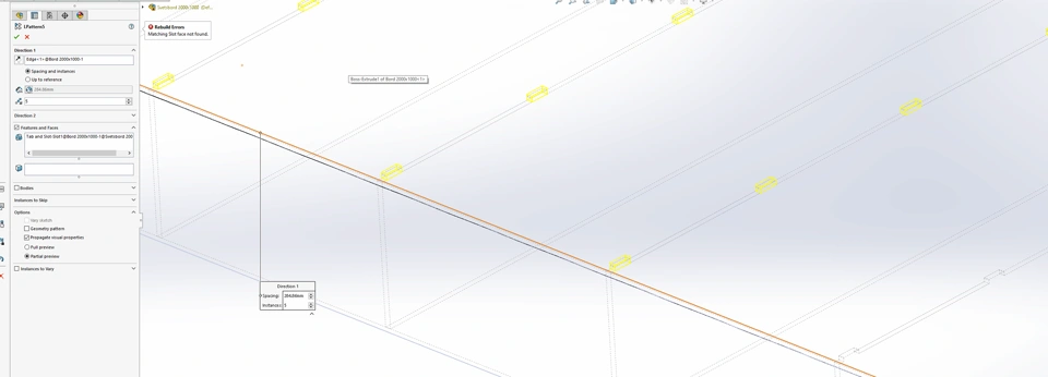

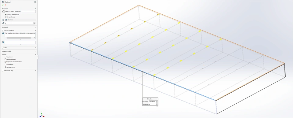

When I try to pattern the slots its fine with 4 copies, but if I add one more it says "Matching slot face not found"
But the part with the tabs are patterned at the same distance, and as it works the first for why does not work with five??
