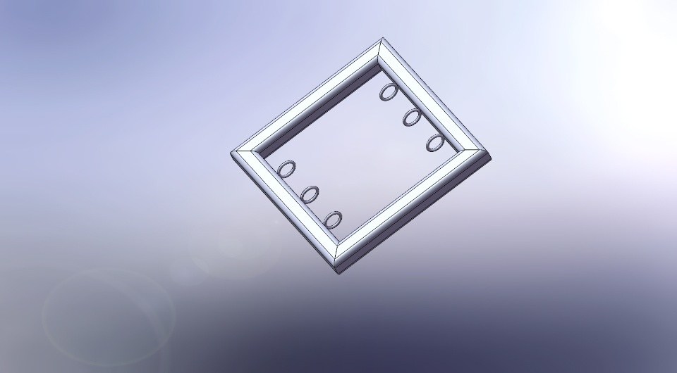

I tried first just making one, then using a linear pattern, then a mirror to do 2 sides.  But in drawing the ring and doing the same for the other 2 sides, they come into the cut list as 2 seperate parts, which they aren't.  I figured this would happen since they are 2 seperate sketches.

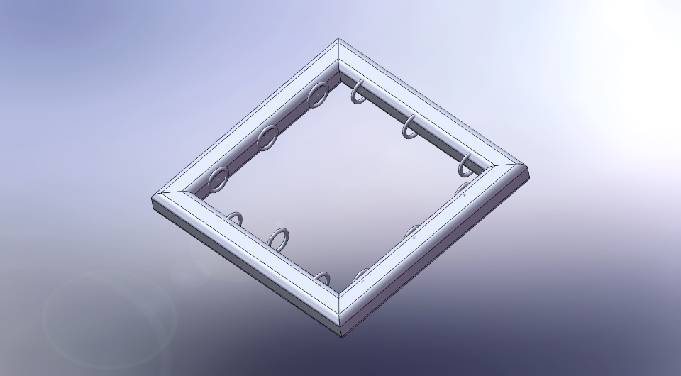

Is there a way to do this with patterning?  I tried a sketch driven, but it will not auto rotate the rings for 2 sides.  Instead of protruding, they lay flat.  I know a circular will do what I want, but I have a square.

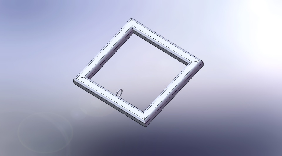

Attached jpg files of my problem.
part1 is just a basic square weldment with the ring on the interior.
part1-1 is the linear and mirror that gives me 2 sides
part1-2 is a sketch driven pattern.
