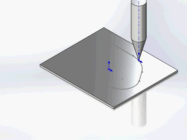

Hi,
     I have a path mate defined which uses a composite curve (5 segments).  I would like to know if there is a way that I can set the path mate motor to run at a different velocity depending which segment it is in.
Ideally I would like to control the velocity based on the displacment from the start position.
With the (path mate motor) expression builder is there a way to reference a sketch dimension to use as a comparison for an if statment?
cheers
Arron
