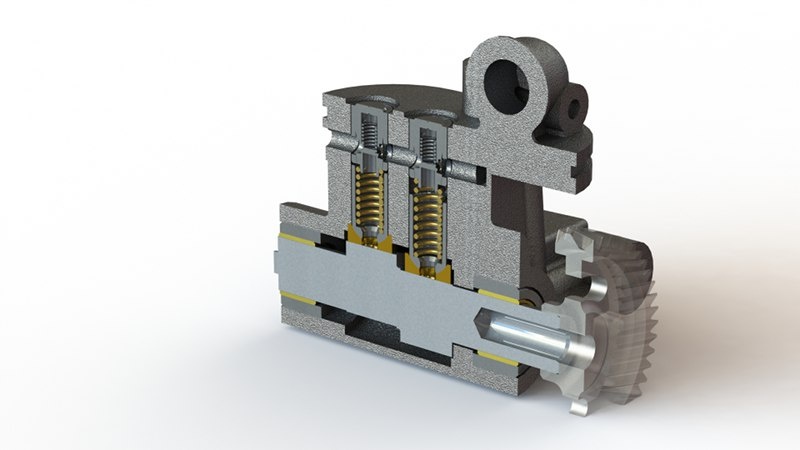

I'm really, really struggling with this.  I have a pump with 4 check valves.  To animate these check valves as the pump turns, I created a sketch with a cam-like profile that rotates with the pump's shaft.  I then used a path mate to mate centroid of the check plate to the cam-like path.  If I rotate the model by hand, it works great.
When I use motion manager to motorize the shaft, the check valves will snap out of the pump housing and end up floating outside of it while still following the path.  Once this happens, I have to delete the mates and start over because all the mates are still active (concentric, plane for non-rotation, and path)  How can I animate these check valves in a way that prevents this error?  Solidworks warns me about using 'free' path mates for animation, but I don't see a way around using this method.  I know this has to do with the fact that the path mate is not fully-defining the parts since the mates can all technically be satisfied by jumping 180 degrees on my circular sketch, but why do the parts suddenly do this?
-check valve is the small plate that sits just beneath the small springs
-check plate is mated concentric to the bore in the housing
-plate right-plane is mated to a plane at the center of the camshaft lobes (prevents plate rotation)
-sketch at center of cam lobes is path-mated to centroid of check plate
-motor is applied to gear, which is fully mated to the camshaft concentric and using planes.
Thank you very much for any help!

This might also make things more clear:

I've had this issue before in other assemblies of various sizes and motion types.  In a simplified example the animation renders out to AVI without issue even if the path-following part is in the wrong place.  Scrubbing back and forth on the animation timeline however causes the following part to jump to the other side of the rotating part.  Once there, the part can sometimes be moved back to it's correct position by moving in the timeline to a point where it suddenly jumps back to where it belongs.  Sometimes this never does happen and I give up, deleting the mate and reproducing it.
My pump model exhibits this same behavior, however once the part that should follow the path jumps to the wrong position it will remain there.
Sorry I didn't post a simplified example assembly.  It's essentially the same as the pump model above only with a camshaft, a hub around it, and a part that moves vertically when the cam lobe passes by using the same path mate principle.  The path is of course free of sharp corners, all curves and fillets are used for smooth motion.

sounds like something to report to your VAR to see if there is a known issue.
based on your description, it sounds like a bug if it is happening in any situation any file.
without the example not sure i can provide any addiitonal suggestions. the only thing i can think of is to try and add an additional mate to try and force things from not changing direction.
a video showing what you're seeing on the screen might be helpful to for others. jing is a good program to make them with.
