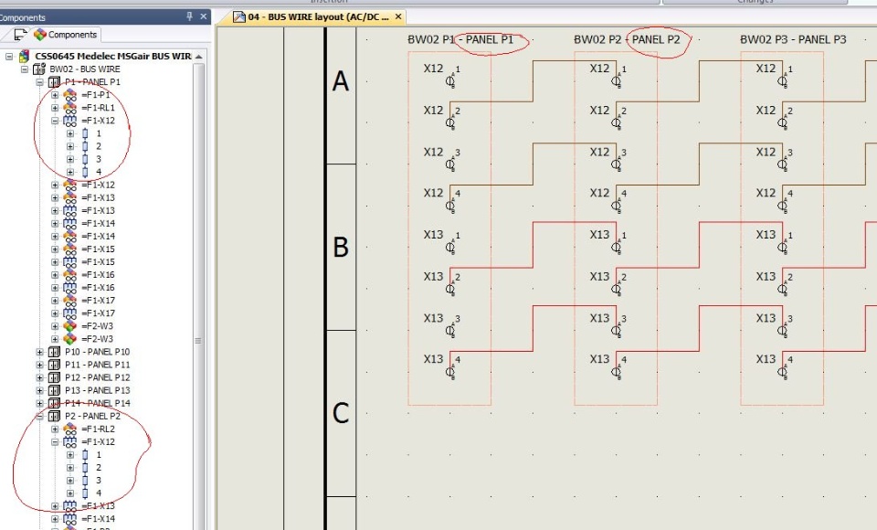

Is it possible to paste special from one location to another prepared location in the same Project, keeping the same terminal strip tag and teminal block numbers?
Below is finished without using paste special. As you can see the terminal strip tag & the terminal block numbers are kept the same. What I want to achive is to be able to copy the whole termial strip from location Panel P1 to location Panel P2 in the SAME PROJECT.
