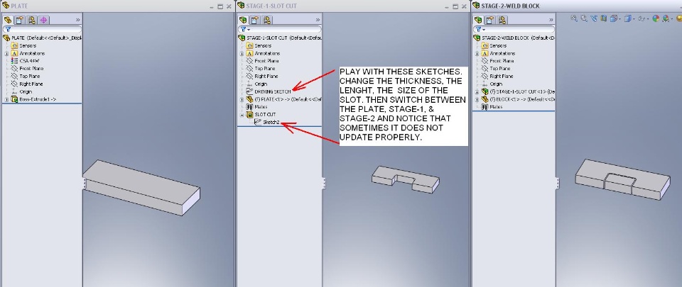

All,
I noticed that some parts are not updating in the context of the assembly.
When I edit the driving sketches and try to update the effected parts,
sometimes they don't update. Its weird because sometimes they do and sometimes they don't.
I also noticed that if the parts don't update, you have to edit the in-context> feature and re-hit ok, then it finaly updates.
I was always under the impression that this should happen automatically when you hit rebuild.
Here is a simple example of what I mean.
Can anyoune confirm this Please.
I'm running SW2010 sp2.0
