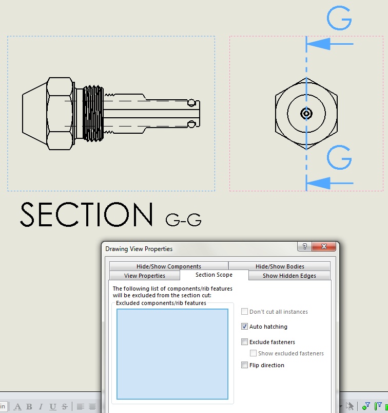

Parts not being cut in section view
Hi all, I've been having an issue with section views today.  I'm trying to get a section view that goes through the entire part.  Normally, this is no trouble.  However, when I do it on this brand-new drawing with the same template as my other drawings, it asks about a section scope now.  Since I want it to cut all I choose nothing for the scope.  Despite this, it refuses to cut the front part of the assembly (and possibly the part inside that part, I can't see to tell).  When I open properties and the section scope, nothing is selected.  I opened the assembly itself and ensured I could create a section view of everything there, but I'd like to understand what's going on with my drawing.  I've attached a photo showing what I'm getting and the empty section scope.  Any ideas?
