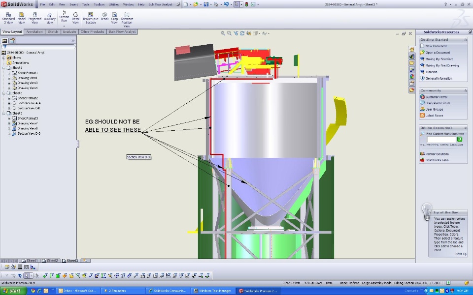

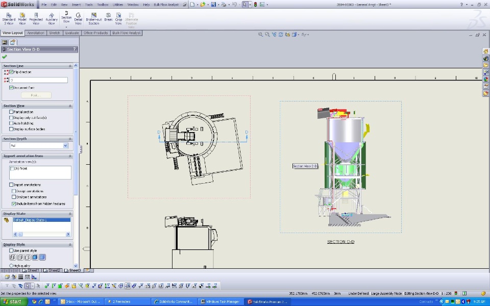

I am trying to create a drawing containing section views of an assembly.  When I create the section view, only certain parts are actually sectioned.  This assembly was created by someone else so I don't know if they have done something to the model that would cause this.
Have tried:
- recreating the view
- changing from partial to full section
- Updated my vid card drivers
- Checked that "Automatically Hide Components on View Ccreation" is unchecked
- No parts are listed in Section scope or Show/Hide Components
Not sure what else to check.
2 days of wrestling with SW, missing views when opening the drawing etc and now this.
Any help appreciated.
