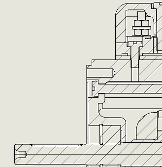

I got a problem with hatchings in my assembly drawings.

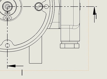

I want to make a sectional view with a 90° cutting line.
I tried several methods, none is working. (Using the sectional view assisstant / making a sketch first and then click "sectional view")
Now every part of this assembly was cut and it looks like:

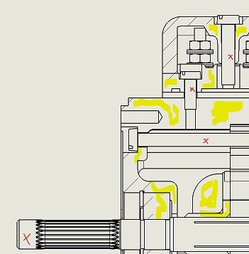

Everything is fine with the hatchings, but if I exclude single parts from the sectional view like the shaft / screws etc...
The red "x" parts were excluded. In the yellow areas the hatchings are now missing.
I tried changing it manually, no effect.
Only if I fill the part with one color, everything is filled. If I change it back, the error occurs again.
