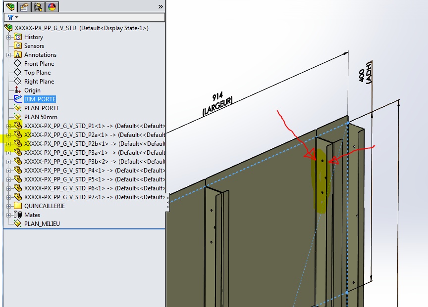

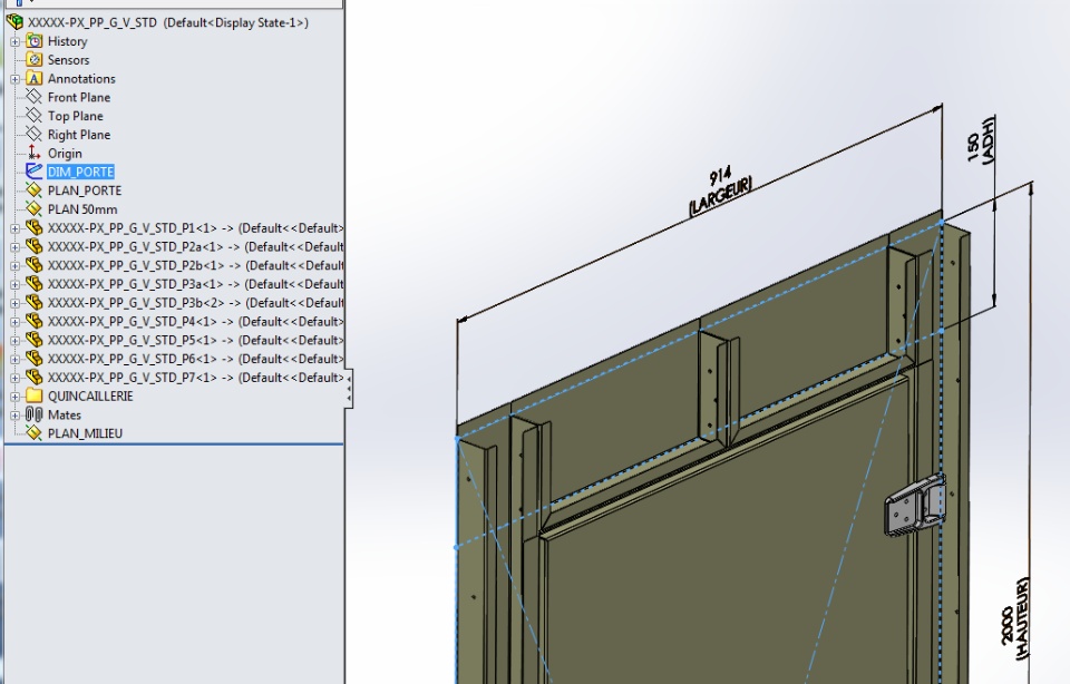

I'm trying to build an assembly of a door in sheet-metal, using a sketch that drives individual parts (in context reference). It works well, except for the hole patterns.
When I change the dimension in the sketch, the part follow in dimension but not my holes patterns. Also, solidworks doesn't give me a rebuilt icon, so the users don't know they have to update the part .
I've read about a SR that addresses this issue, but we won't be updating to SW2015 this year and i need a way to do some simple automation with SW2014
