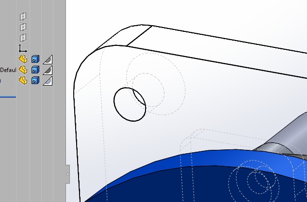

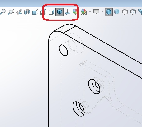

A part started acting strange yesterday.  In the part file, it will only show with hidden lines in every display mode.  In the assembly, it will show correctly if I select the view through the FM manager tree....unless it's on default display.  Then it goes to hidden lines visible when everything else is shaded with lines.  I have tried different materials, restarting, restarting again, clearing local cache in PDM.
Quadro P2000 on latest certified driver.
