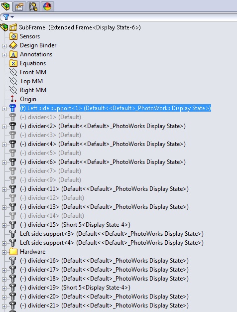

part files are show in the feature manager as a toolbox component?
I have issues with my Workgroup pdm software when it comes to revisions. I cannot check in my main assy as it comes up with syntax error 200. It looks like SolidWorks is renaming my parts as toolbox part files on the initial build of the assy. So a part file is now known as a toolbox part. As i am not doing revision control of toolbox parts it won’t check it in, which is why i believe I’m getting the syntax error 200.
Does anyone know of a setting i may have hit by mistake in toolbox, or in options or in the vault admin?
This issue may be because i upgraded to premium from professional last year. I have just noticed the issues now when I’ve tried to use PDM workgroup. Im usaing SWx 2012 SP1.0.
Any help would be greatly appreciated, thanks.
I have attached a screen shot of what im looking at in the feature manager.
