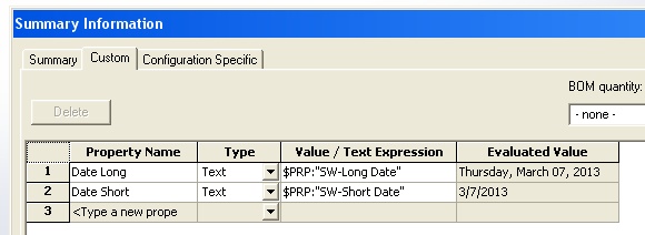

In a drawing, I can automaticly populate the date the drawing was created, and format the date from within SolidWorks (Long Date / Short Date / Time Included / Time Not Included).  Nice options, and I don't have to mess with the computers regional setting which other programs are pulling information from.
In a part file however, I don't seem to have the option to format the SW-Created Date property at all.  The only way I can see to manipulate its format is by manipulating my computers regional settings.  Is this true, or am I missing something?  If I'm not missing anything, why not have the same options available everywhere you can use the SW-Created Date custom property.
