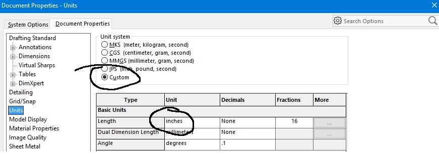

Set the document units to inches and try to add a global variable in mm or cm units

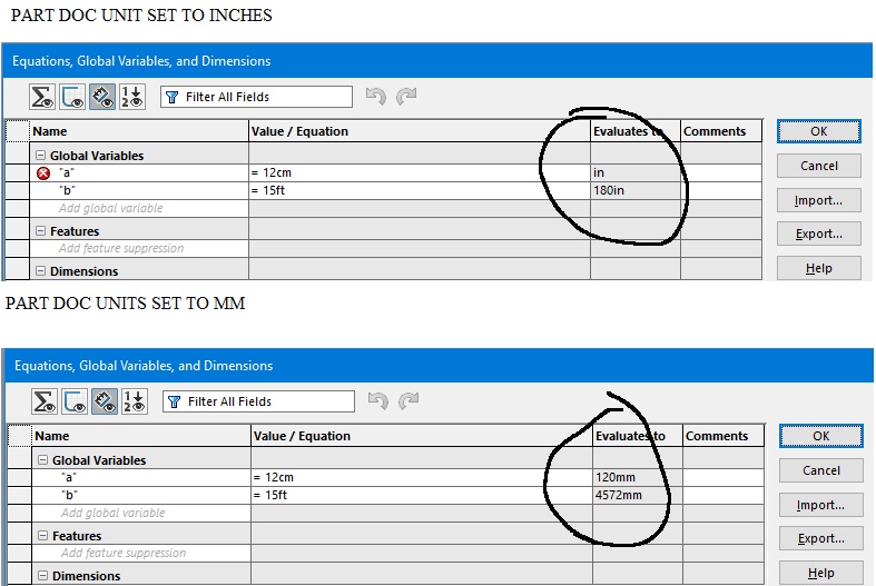

If your document length unit is set to inches then you cannot specify metric units in the equation manager.
But you can specify imperial units for GV if the document length is set to mm (metric).

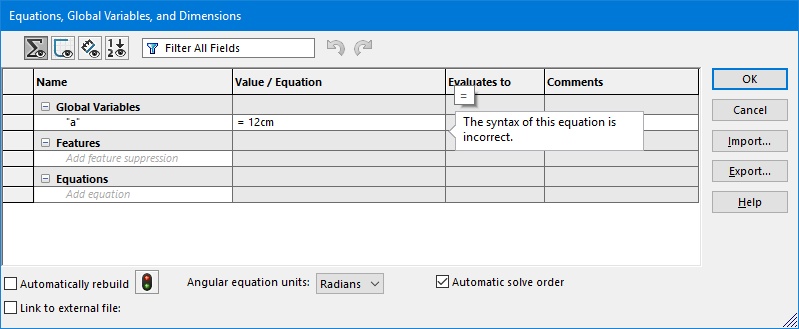

SW 2018 adding a 12cm global variable with document units set to inches.
