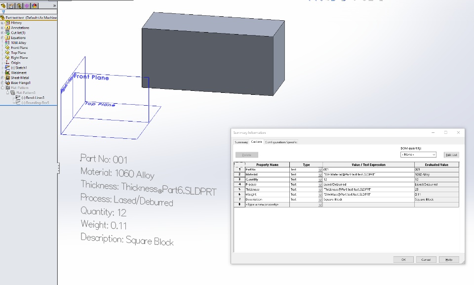

Im trying to set up a part template for sheet-metal usage, that automatically updates a note in the template that is linked to custom properties.
So that when i create DXF/DWG i wont have to add thickness, material,
But cant seem to get Thickness of part to show the estimated value, but it only wants to show Value/Text Expression.
Material shows esitmated value,
weight shows estimated value
but thickness shows Value/Text Expression
Anyone know why material and weight work but thickness wont?
Attached Template and test part.
