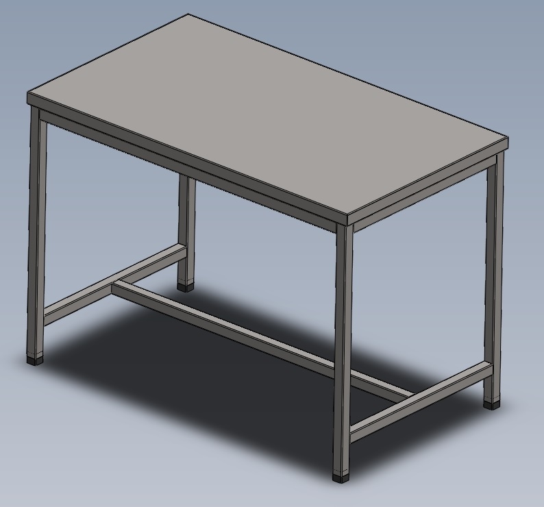

Hello dear, I have the following problem:
I have a stainless steel table, consisting of 9 parts. I need to make it parametrical in order by changing the overall dimensions of the table (e.g. 1200x700x850 to 1215x720x800) SW to calculate and update the parts files and respectively the drawings files. Up todate I have managed to solve it half way by creating design tables in every part file and creating configurations in the assembly file. This is not satisfactory enough as I have to open every single part file and insert the new configuration dimensions and then open every drawing file and update the configuration there, etc. Is it possible to skip this whole process by creating one table or smth and link it's boxes to the corresponding SW files? OK, this is how I imagine it, but there might be another way. Please help.
