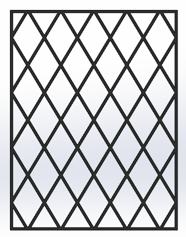

I have to design a window panel - something like this
For my input parameters I have a height and width.
Also num horizontal and num vertical panes.
With a bit of messing about I managed to find a solution close to what I require like this.

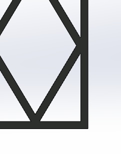

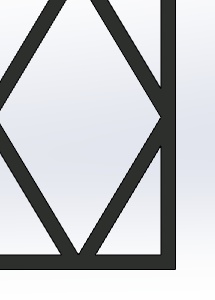

Can you spot the difference?
I've got

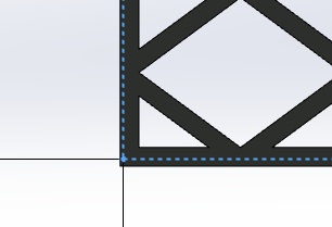

and I need
I got the second image by cheating - but the panel is now the wrong size.

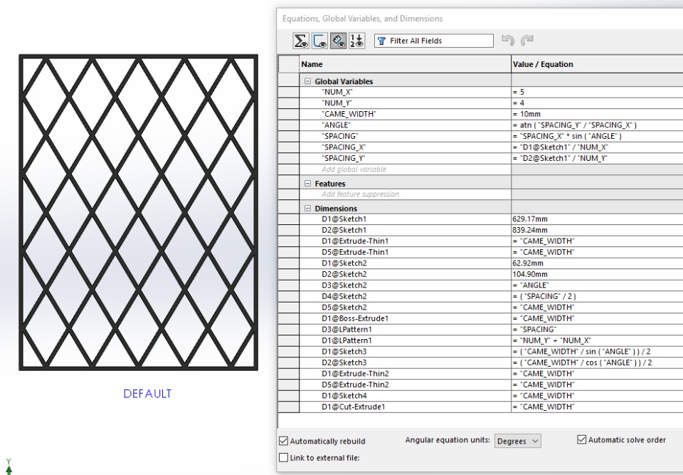

I can probably get it the right size by trial and error.. but I don't like giving up.
Anyone good at maths - or know a SW trick?
2018 part attached
