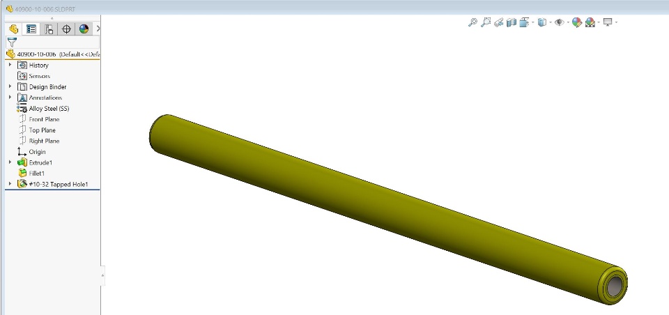

Here's the problem. If I have a simple part:

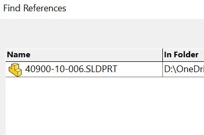

Here's the references:
That's what we would expect.

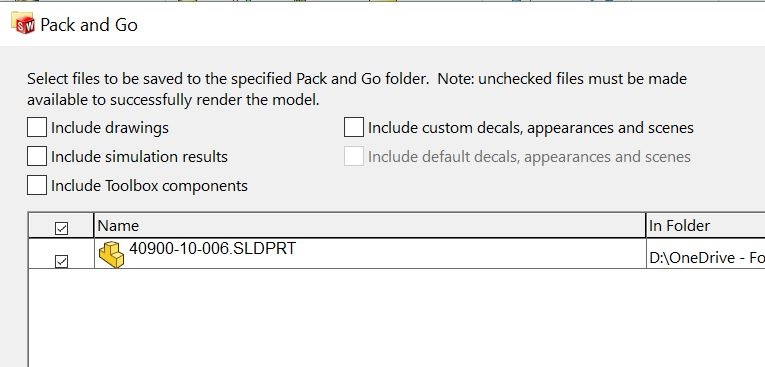

Here's the Pack and Go WITHOUT drawings:

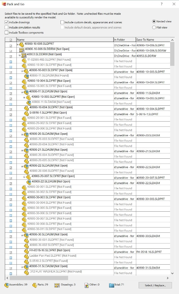

Again, that's what one would expect. BUT, then if you click the "Include drawings tab" you get this:
for some reason it's trying to grab stuff from all over the universe!

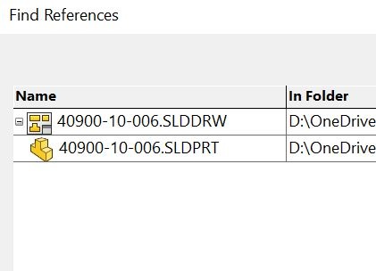

Now you may say that the drawing is somehow referencing all these files, but it isn't:
So the drawing only references itself and the part.
WHY does Pack and Go grab all the unrelated files!!?? This means when I try to do a Pack and Go to send files to a supplier, all the crap is sent along with it. We have to manually expunge the extra files, which basically negates the functionality of Pack and Go.
