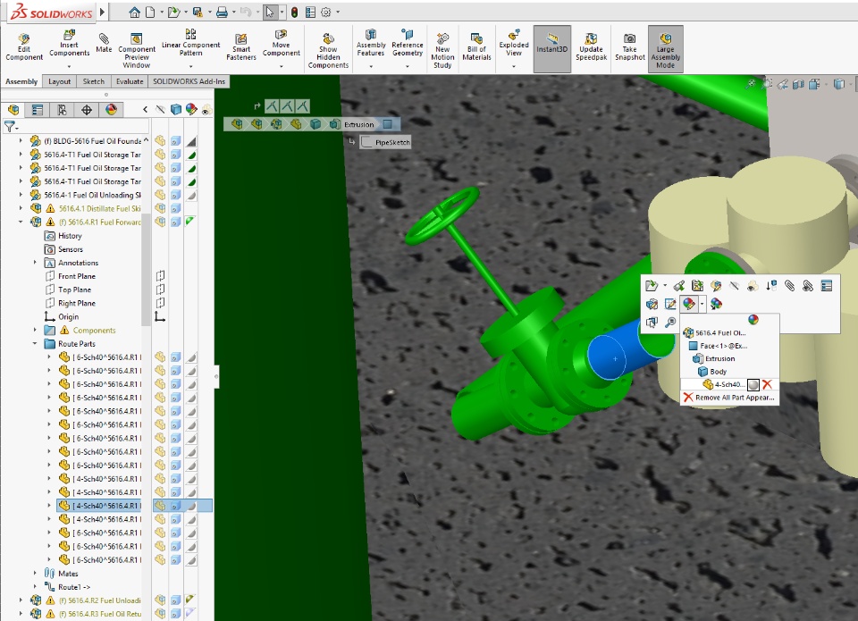

I've come upon a case whereby a override material (bright green) has clearly been applied to a subassembly, but doesn't get listed when clicking the appearance dropdown on any of the affected child parts:
The selected part in this screenshot appears green, just like the rest of the subassembly - but none of the subassembly parts list the green material in their appearance stacks. Furthermore, when using the C# API to traverse the full assembly, I see no reference at all to the green material at any level of the component hierarchy; only a flat white material appears to be present / connected to these parts.
