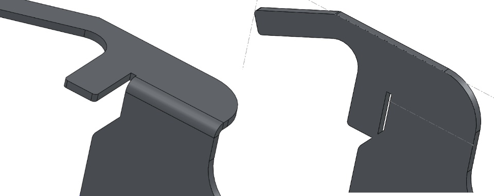

How intelligent is the detection of impossible flat patterns supposed to be in sheet metal?
I was surprised this one isn't an error. not when folded, not when flattened either.
It seems that material the other side of the fold is not considered correctly?
SW2016 SP5
