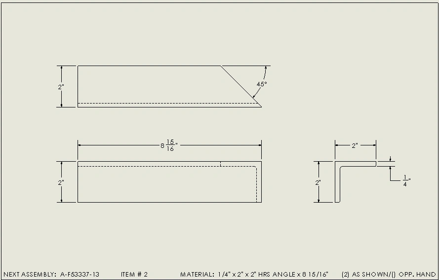

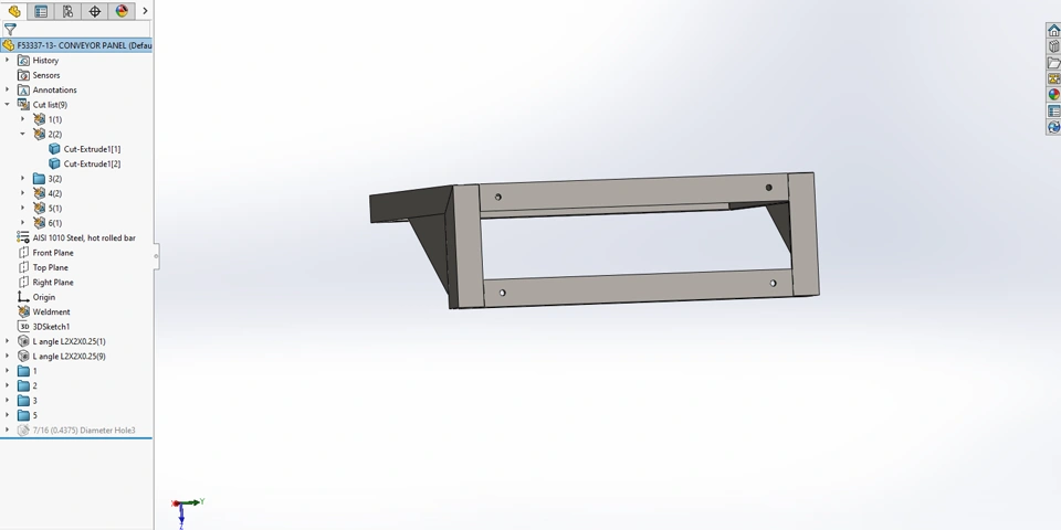

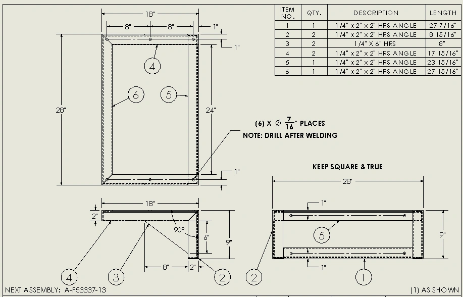

I'm trying to make a couple of drawings on Solidworks for a weldment frame. My co-worker made a template awhile back where we attach the text to the view of the item and it would call out the information for each part as shown in the image in the bottom (Item #, material, and quantity). However, he hasn't found a way for it to work for opp hands as shown in the image. The drawing says two but they're both different. Is there a way we can call out these two parts to say (1) as shown/(1) opp. hand. For reference I combined the opp hand with the right hand in solidworks to make the quantity 2 in our weldment list . I provided some pictures for clarification. Thanks. Drawings And DetailingSketchingSOLIDWORKSDocumentation, Certification, And Training
