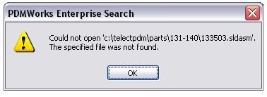

With Solidworks application not running, if I dbl click on file on desktop Solidworks application will open, but will not open file.  Get error message stating can not find file.  See image.
If you click OK, leave solidworks app open, then go back to desktop and dbl click file, Solidworks will open file just fine.
Also, seeing the same results if you do this from EPDM.  If Solidworks app not running, when you dbl click Solidworks will open, but file will not.  Get the following error message.  See image.
If you click OK, leave solidworks app open, then go back to EPDM and dbl click file, Solidworks will open file just fine.
Thus if Solidworks is running we do not see this issue.  However if trying to open file without solidworks already open seeing this way to frequently.
