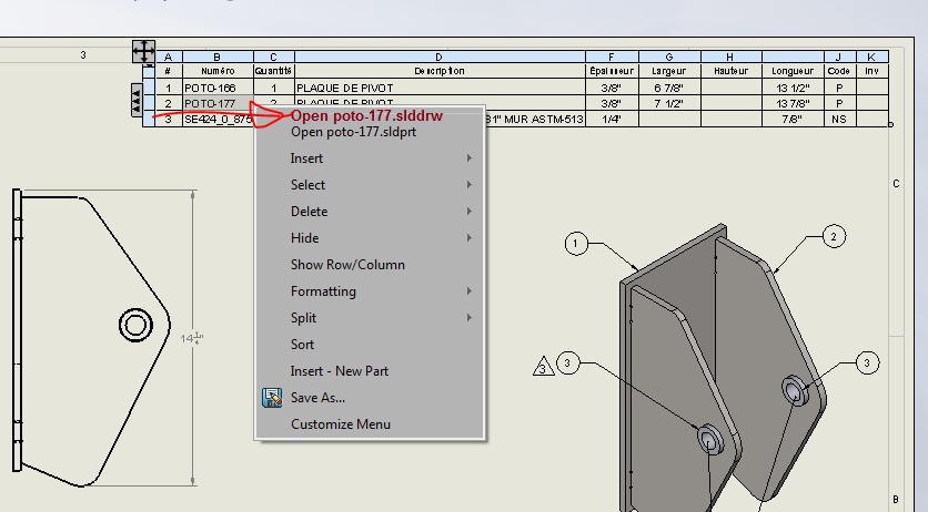

Hello,
Is it possible to open a part drawing from the assembly's drawing? I often have to edit part drawings and to do so I end up having to right click on the part in the BOM to open the part and then right click again to open the drawing. It would be useful to be able to do this from inside the assembly's drawing itself.
Perhaps it already exists and I'm unaware of it too, I'm on 2016. If not, then ER on the way
This is what I mean:
