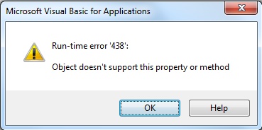

In other words, get the path to the file that contains the selected face.  However, both commands produce the following error:
Can anyone tell me what I'm doing wrong?
