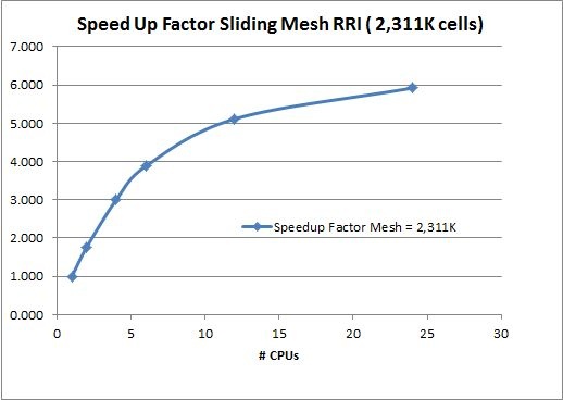

1. It takes much more CPU time to run by 2 solvers than by , let say 64 solvers simultaneously. It is so because the speedup is not linear. I am attaching the Speed up curve of pump simulation (sliding mesh) for your reference with SW2017. You can see that above 4 CPUs the curve start saturated and practically there is no speedup above 16 CPUs.
