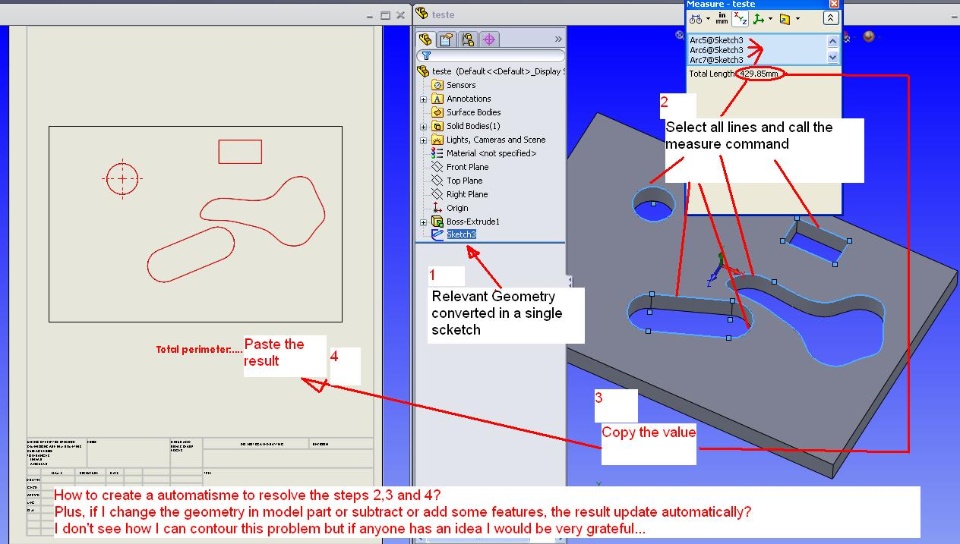

Hi all,
I'm trying find a way to obtain  the total perimeter from a unique scketch  (created in part)  and put automatically the result of the perimeter in legend of the drawing. When I have a unique geometry ( a round for instance it' s easy) but, when I have multiple geometries in a single scketch ( round plus square for instance) I don' t see another way without select line by line (in part file), call the measure command and copy the result to the drawing. It' s boring!
Someone has an idea or suggestion and want share one solution in order to bypass this process?
