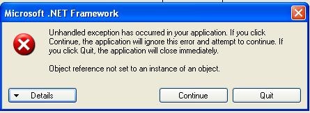

I have an interesting dilemma that hopefully has an easy solution.  My PDM trigger, which occurs during a drawing check in, works just fine when invoking a stand-alone .exe like Notepad.  The stand-alone program I wrote, which saves out the active drawing document as an eDrawings document, also operates fine when executed normally.  (That is, it saves the eDrawing in the proper folder, no problem.)  But when I try to invoke my stand-alone .exe through the trigger I get a Microsoft .NET framework error that says, "Unhandled exception has occurred in your application ... Object reference not set to an instance of an object."  I have attached a .jpg showing the full error.
Any ideas how I can get the trigger to successfully invoke my .exe?  Here is the code in my exe:
