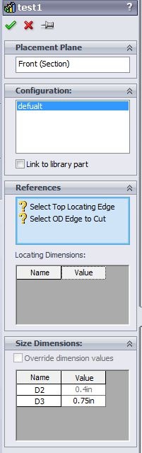

I do not have knowledge on creating library features. I just stared to create library feature for O-ring groove. I am pasting the steps that I have followed while creating a sample.
Step1. Created a basic shaft
Step2. Created a Groove profile and made revolve cut and saved this Feature as library feature
When I try to drag and drop the the library part on some part it asking for reference as I seen in image
and I selected the same, then it is saying unable to create library feature with selected reference.

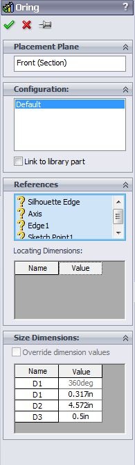

I searched in internet and found one O-ring groove library file, when I drag and drop it, it is asking for the locating edge and OD. Could someone just check and let me know how it is created.
