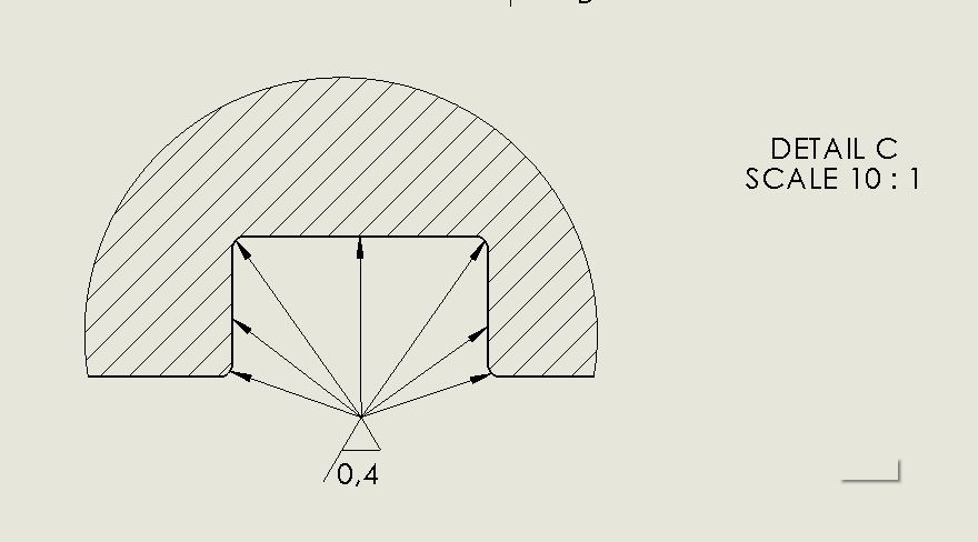

Our o ring groove finish is critical - 700bar Hydrogen - and I'm trying to detail the finish, I could put a note saying "all o ring groove surfaces 0,4 finish" but I'm concerned they'll miss the lead out fillet so currently I'm going with this but it doesn't look very elegant - any suggestions?
Cheers
