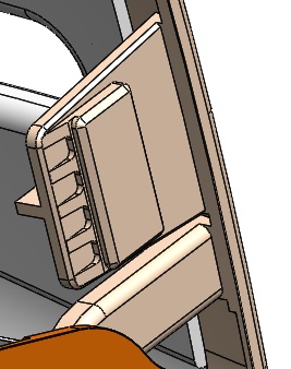

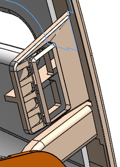

Anyway.. I've updated, my system doesn't hang anymore, but I've discovered
an annoying little thing in SW that I was hoping someone could help me fix.
In some models, when selecting a face, other faces nearby turn invisible.
This only happens on the part (in an Assembly) that you've selected a face
from.  All other parts are fine.  Not all models do it.  Screen capture below..
before and after face selection.
I have a gut feeling that some setting in nVidia control panel could fix this
but I haven't had any luck on my own (trial and error).  Anyone have any
thoughts?
