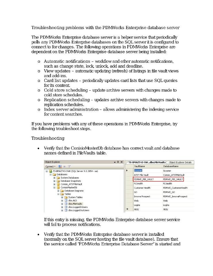

Notifications does not working
I try to setup some workflow notification but does not working at all. Neither transition notification or state notification. I must mention that send e-mail action from transition are working. We use database for communication. I verified also DocumentActionInfo and BroadcastEvent tables for any row. I restarted database service. Any of this solution does not resolve our problem.
If any body know any solution of that, please help.
Windows 2008
SQL 2005 sp.2
PDMWE 2008 sp.5.0
SW 2008 sp.5.0
