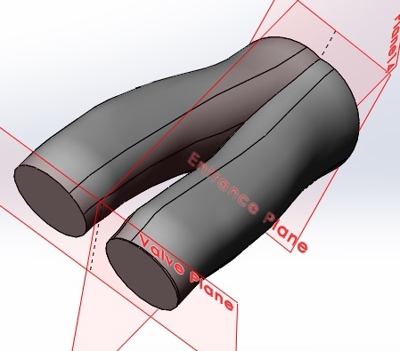

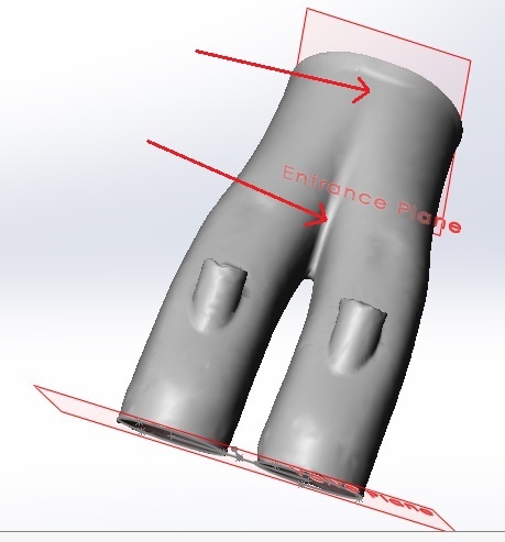

I'm trying to do a fillet operation between two merged lofts that results in something that looks like this (shown by red arrows) (this is a 3D scanned file):

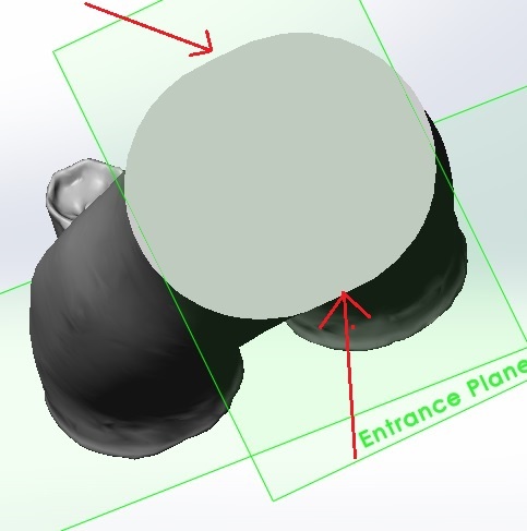

As you can see in the next picture, the fillet ends up becoming a flat service so that the profile of the face is flat on the top and bottom:
This is my reverse engineered version, where you can see the join between the two lofts which needs filleting:

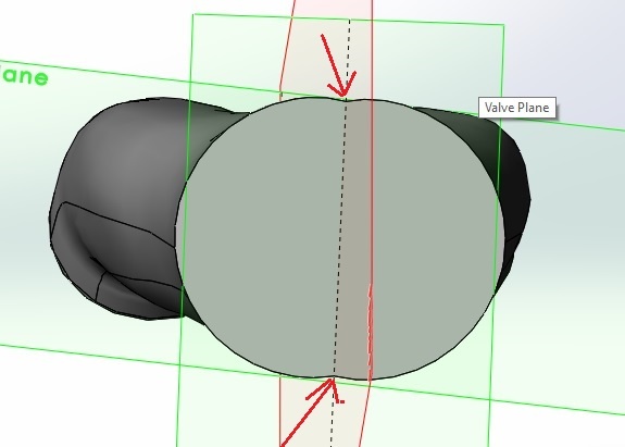

And in the next picture, you can see that the profile of the face is not flat on the top and bottom:
How should I go about getting the fillet so that it matches the one in the 3D scanned model?

Since nobody is answering this one you might need to explain it a bit more. Can you do that ? The attached file has some extra steps in it ?
PS
PS 2017-02-12
Simon.. suggest blending using a combination of cuts (splits); boundary (or lofts) and/or fills..  (example attached)
SF
SF 2017-02-13
Thank you Paul, that's exactly what I was looking for!
